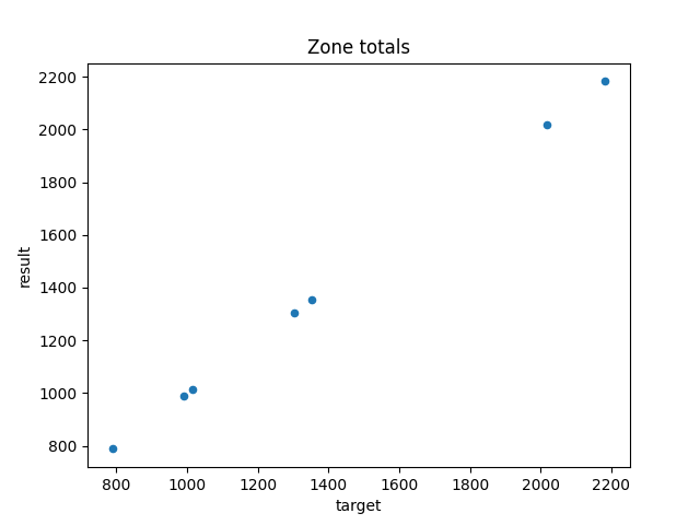

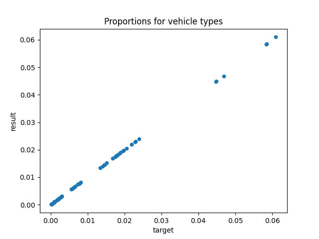

The convergence threshold can be as low as required, as it is nearly guaranteed to converge
rv.process(conv_threshold=0.001, max_iterations=50)
# Two convergence scatter plots are also saved with the outputs for a quick sanity check
rv.save_results(join(gettempdir(), "veh_distr.csv"))
