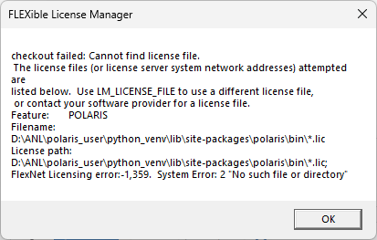

In case you fail to install the license or the license is not correct, you will receive a message like the one below.
