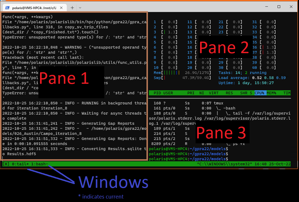

TMux Basics#
This will place the user in an environment with three panes as shown in the below figure. In general pane 1 is used for watching the standard output of the runner, pane 2 shows the CPU usage and pane 3 can be used by a user to manipulate the filesystem or watch the progress of a run via other log files.
The internet is full of useful resources for mastering tmux but a few basic commands are generally all that are required to use a given session.
Important
Note that all key-combos start with CTRL-b followed by a single character, i.e. the CTRL key should be released after pressing b and before pressing the second part of the combo.
