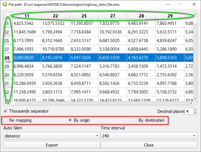

If the user opens a skim while having a supply file or projects opened in the plugin, the user is presented with a slightly different interface, where they can choose to plot a matrix by origin or destination.
Plotting a matrix
The user can select to either just visualize the matrix and not map it, or to map rows or columns (highlighted in the red box) of the active skim matrix. After choosing what to map, the user can just click on the matrix headers (rows or columns, highlighted in green) and see the values corresponding to each one of the cells in the row/column selected

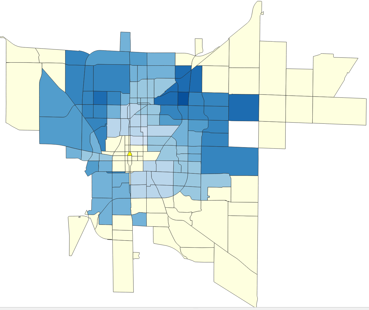

Matrix plot result
The zone corresponding to the selected row/colum will be selected in the zone layer (usually highlighted in bright yellow) and the zones for which cells are empty or infinite in the matrix will appear in light yellow, as shown above.
