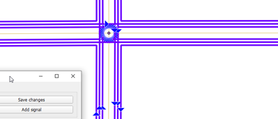

Selecting the option to explore intersections has the same effect as clicking on the ico1 icon in the Polaris ToolBar.
The mouse cursor will change shapes and you will be able to click on a node for which you would like to show the connections and signal information for, as shown below.
Intersection editor

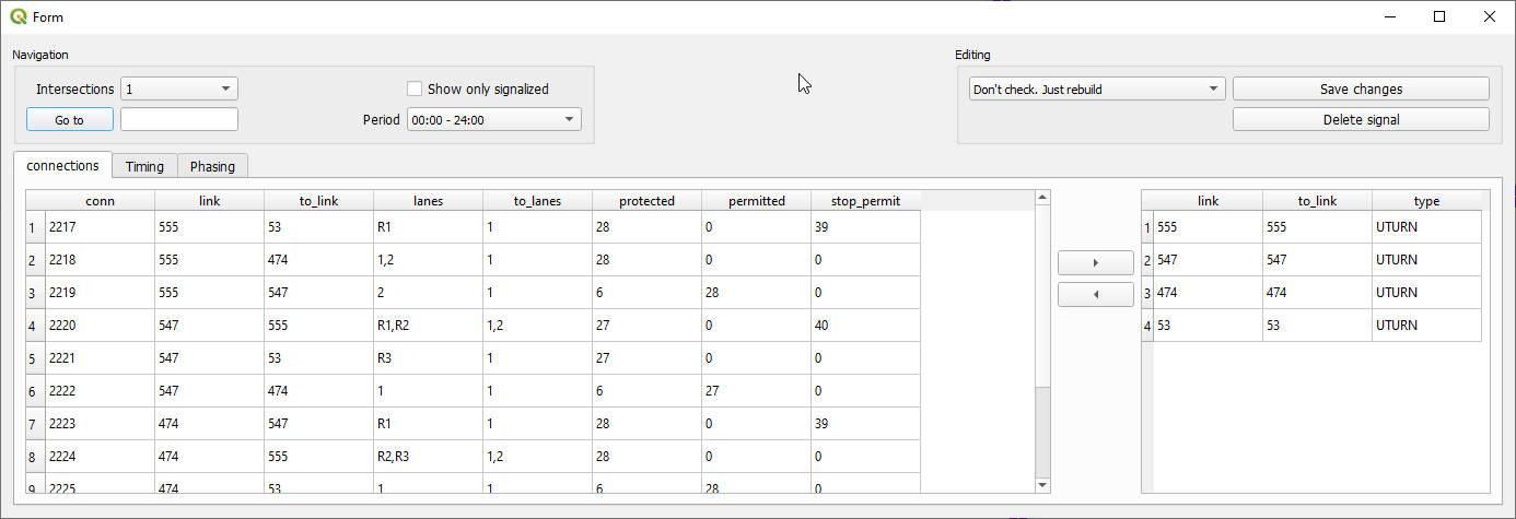

This first screen allows you to see all the connections available for that node and the connections not currently available, allowing you also to remove existing connections or adding others at will.
Turn movements
While the data can be seen on the GUI, on the map all the connections will be rendered any time a new node is selected, and selecting one or more connections on the screen will select said connections on the map and hide the others.

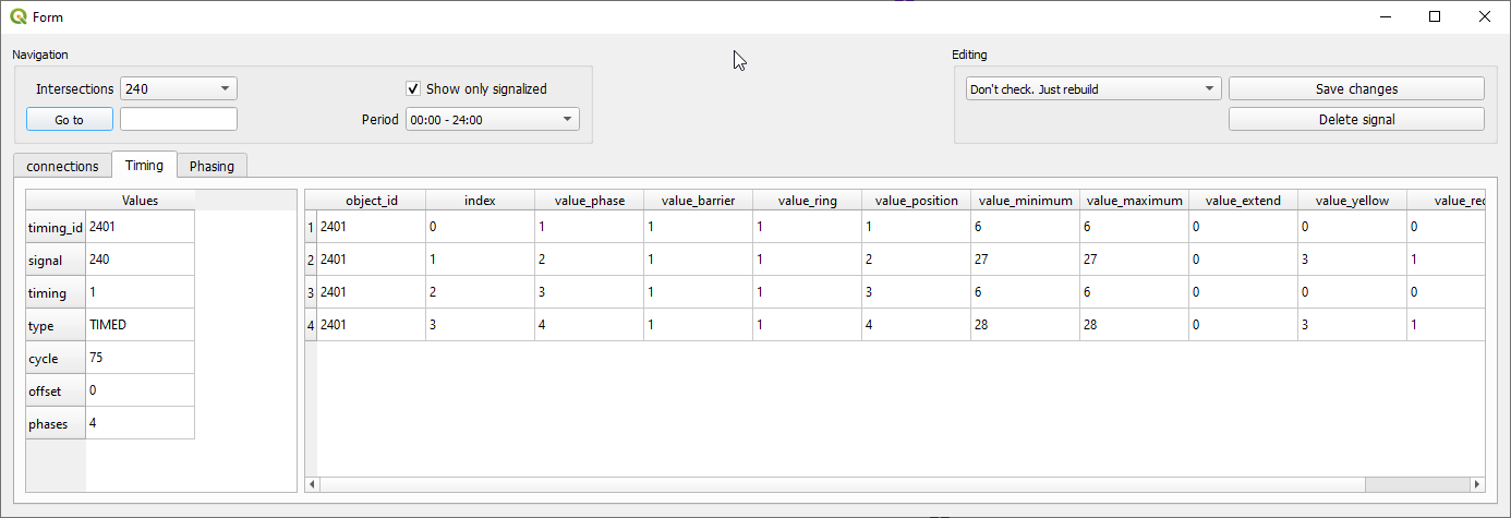

The second and third tabs on the intersection GUI are only available on intersections with traffic signal control, and the timing screen has no editing purposes, but displays all timings for all phases on that particular signal control.
Signal timing

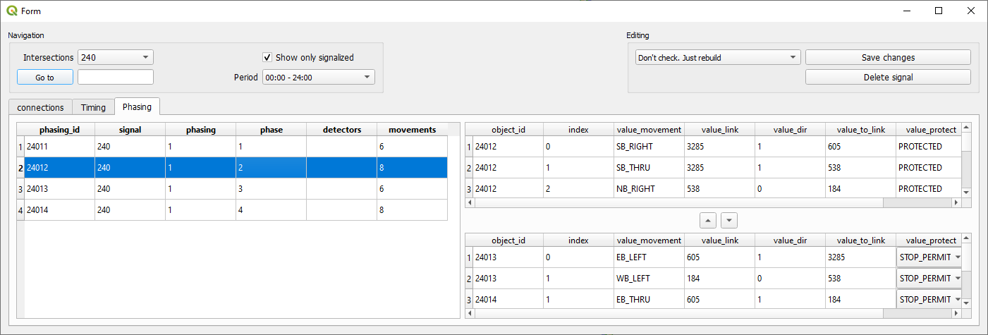

The third and last screen allows the user to see each phase independently, and by selecting them on the left side panel, all movements in that phase will be rendered according to its priority (i.e. protected, permitted and stop permit).
Signal timing
The user can also add and remove movements from each phase, but the results are not checked for feasibility and may result in a crash in Polaris.

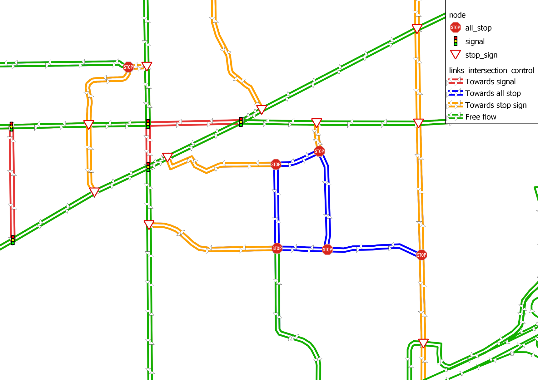

As a result of these two points, creating the intersection control map is slower than other styles (it may take a few seconds to finish), but it looks like the following:
Intersection control styling
Note that the yield sign indicates the presence of a 2-way stop, while the stop sign icon is reserved for 4-way stops.
Finally, the color of the link has to do with the intersection control type for the node it is going TO.
