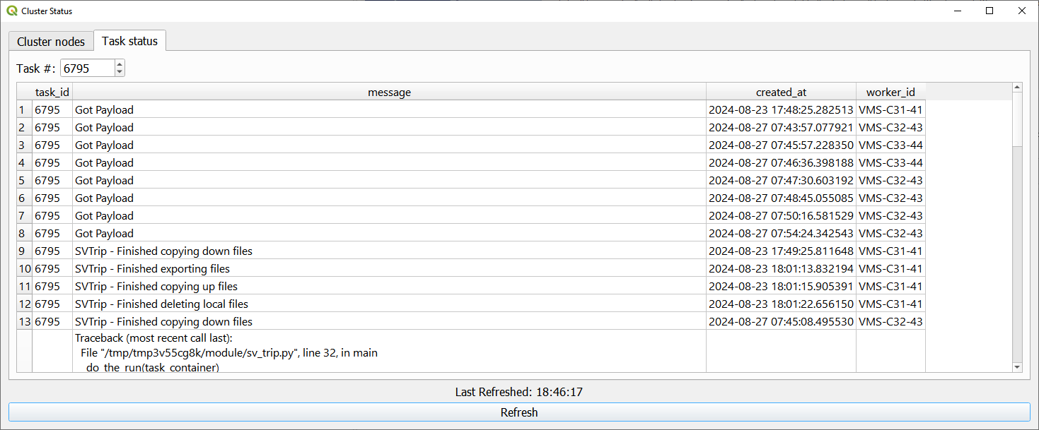

Double-clicking on nodes with valid task IDs will switch the task status screen with all available information on that task.
Example task status window with information on a specific task ID
Task status can also be retrieved for any non-active task by typing their their ID in the spinbox above the task status table.
