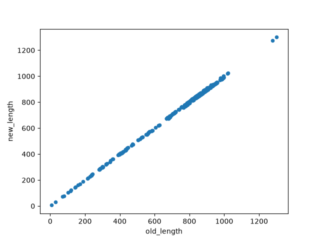

Let’s compare the distances now
new_lengths = new_net.tables.get("Link")[["link", "length"]].set_index("link")
new_lengths.rename(columns={"length": "new_length"}, inplace=True)
old_lengths = old_net.tables.get("Link")[["link", "length"]].set_index("link")
old_lengths.rename(columns={"length": "old_length"}, inplace=True)
old_lengths.join(new_lengths).plot.scatter("old_length", "new_length")
plot changing model projection
<Axes: xlabel='old_length', ylabel='new_length'>
