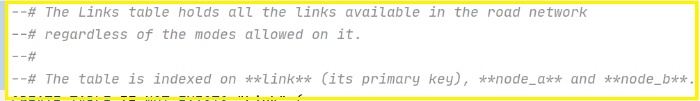

The auto-generated pages for table present in the model can carry documentation over from the SQL files where they are includes.
The basic principle is that any line beginning with –@ in the SQL file will be copied to the auto-generated documentation as raw restructured text, so formatting such as bold and italic or even bullet points are possible and welcome.
One example is the documentation for the Link table, which looks like this in the raw SQL file
SQL file documentation
And it is rendered like this
Rendered SQL documentation
