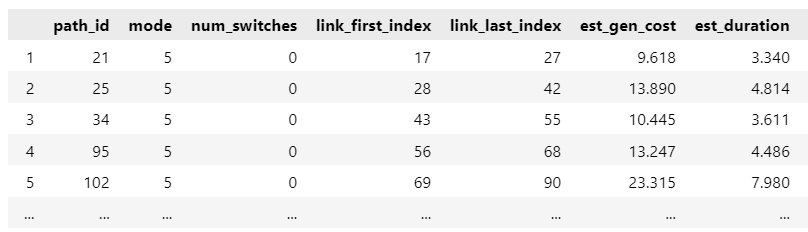

Multi-modal paths#
Multi-modal paths attributes and the associated detailed link trajectories are also stored in the H5 file and can be retreieved similarly to the regular paths.
paths = results.get_mm_paths()
paths[paths.link_first_index > 0]
result.get_path_mm_links(21)
