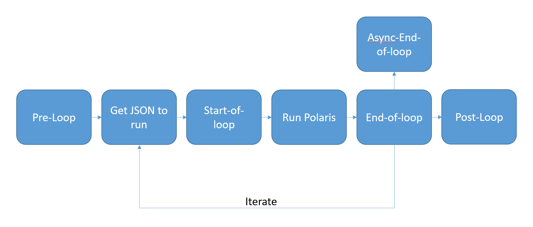

The main form of an iterative run of POLARIS is shown in the image below and described here:
  1. Determine which iterations will run
  2. Do any pre-loop setup
  3. For each iteration
    1. Do any pre-processing required for this iteration
    2. Build an iteration specific scenario.modified.json configuration (starting from the template)
    3. Use the POLARIS engine to do a full day simulation using that scenario.modified.json
    4. Copy back results from the simulation sub-directory to the model root directory
    5. Run any post-processing for this iteration. There are two sets of these:
      1. In-line processing (i.e. required prior to running subsequent iterations)
      2. Asynchronous processing which can be run in a background thread while the next iteration starts (e.g. zipping up outputs of previous iteration for archival)
  4. Do any post-loop cleanup
