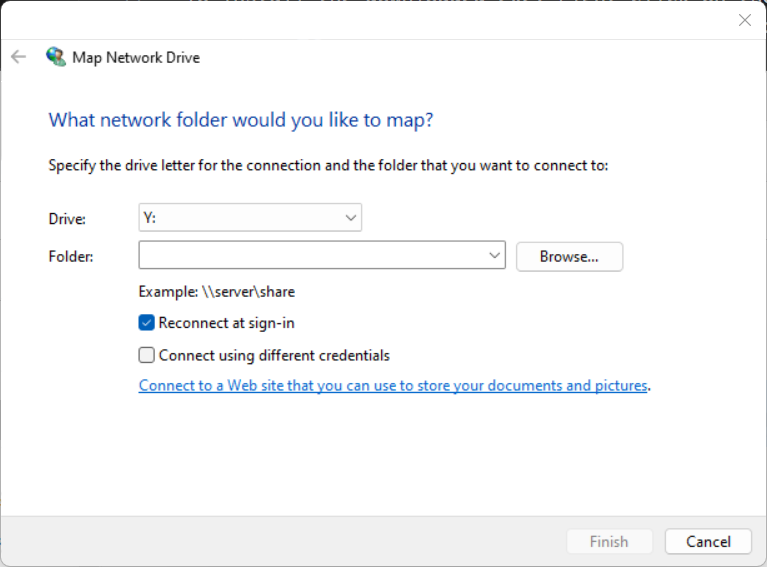

  • From File Explorer, go to This PC. From access bar, right click on “This PC” and select “Map Network Drive”.
    Mapping a Network Drive
  • Here, choose a “Drive” and enter the full directory to the server location where data will be moved between VMS fileserver and LCRC, and finally click finish.
