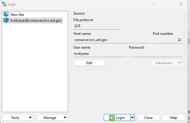

Example of crossover shown below. Other LCRC HPCs are accessed the same way.
  • Step 1: SSH into crossover.lcrc.anl.gov on the terminal. You can use either putty, VS Code or your terminal of choice.
