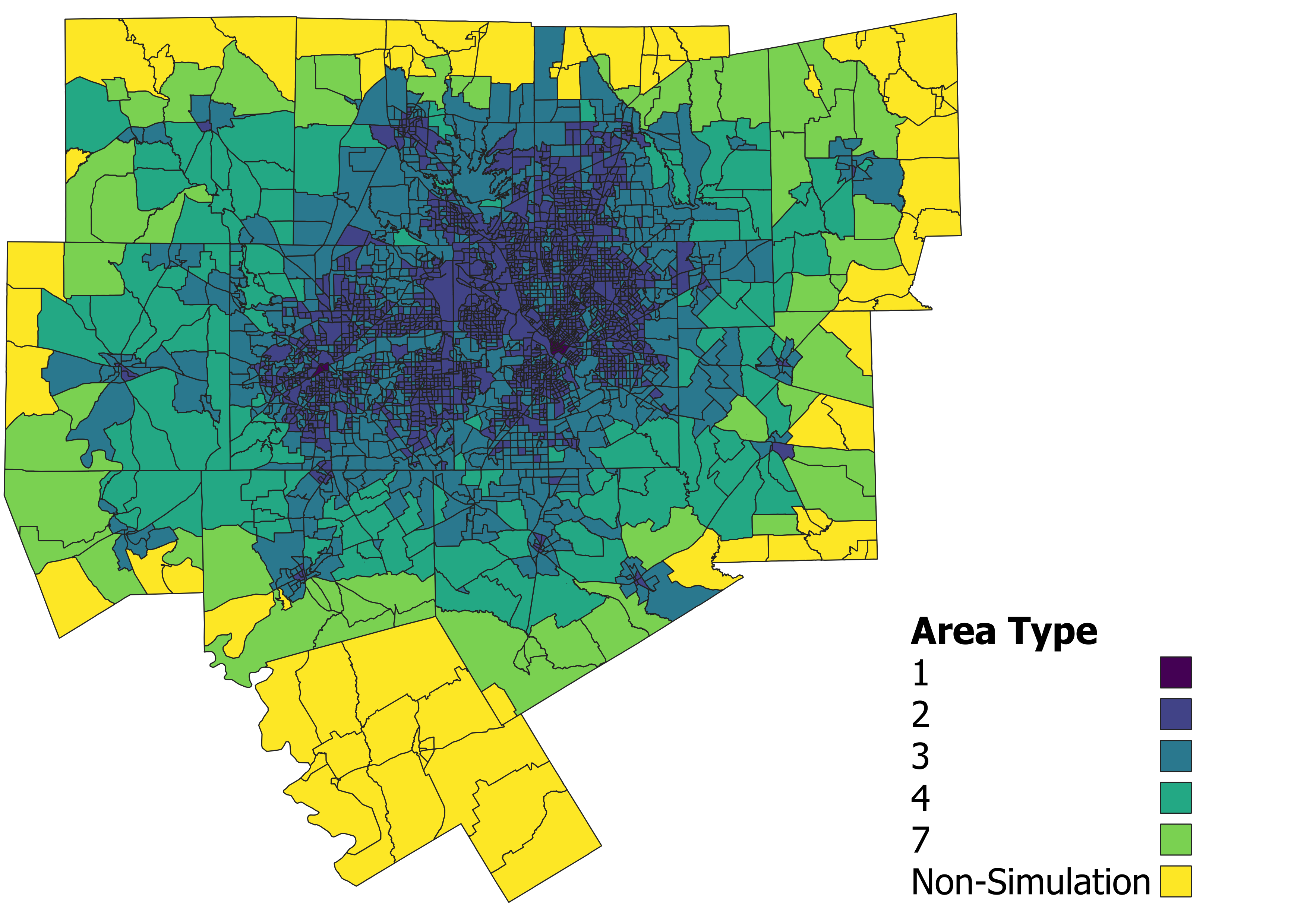

The figure below shows the zones set as Non-Simulation in the DFW Polaris model.
DFW Area Types by Zone
