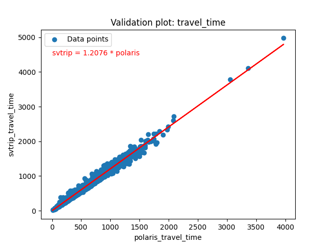

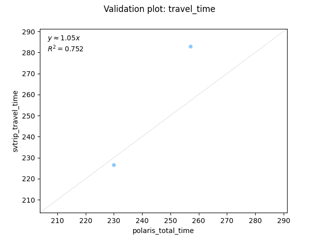

Create an SVTrip class object and initialize with relevant parameters
svtrip = SVTrip(pol.demand_file, pol.supply_file, pol.result_h5_file, logging_level=logging.DEBUG)
# SVTrip scales very well, but Windows has a limit of 60 threads
svtrip.parameters.execution.n_workers = 1  # The example we have here is so small, that we can only use 1 worker
svtrip.parameters.execution.jobs_per_thread = 15
svtrip.parameters.output.export_folder = output_dir
Load demand and supply files from POLARIS
svtrip._load_data_from_polaris() # loads trips and trajectories from POLARIS outputs
SVTrip is very resource intensive, so we will limit the number of vehicles to process Let’s only process the first 9 trips for this example, otherwise it takes too long to run Remember to remove this line if you want to do a full run from your POLARIS outputs
svtrip.isolate_trips(range(1, 10))
Set a random seed for the stochastic speed profile generation
np.random.seed(123)
svtrip.run()
Total running time of the script: (1 minutes 55.830 seconds)
