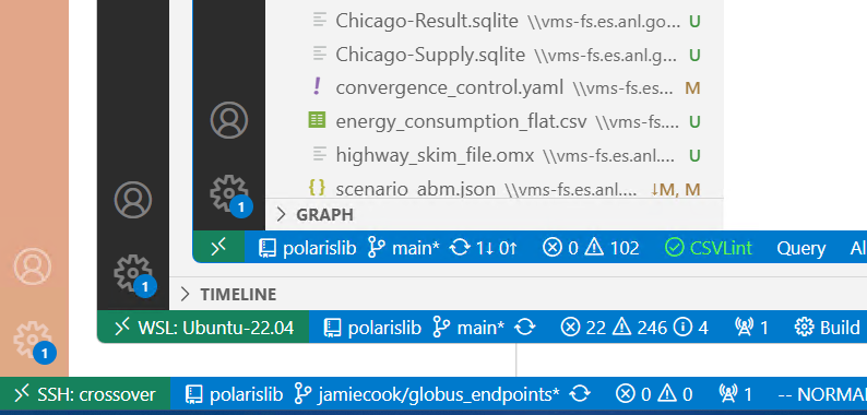

You can see which type of VS Code project you are currently operating in (local, “Remote - WSL”, or “Remote - SSH”) by checking the green connection icon in the very bottom left of the status bar. An example of each of the three types is shown below. This green section can also be clicked as a shortcut to bring up the “Remote” connection commands.
Status Bar
